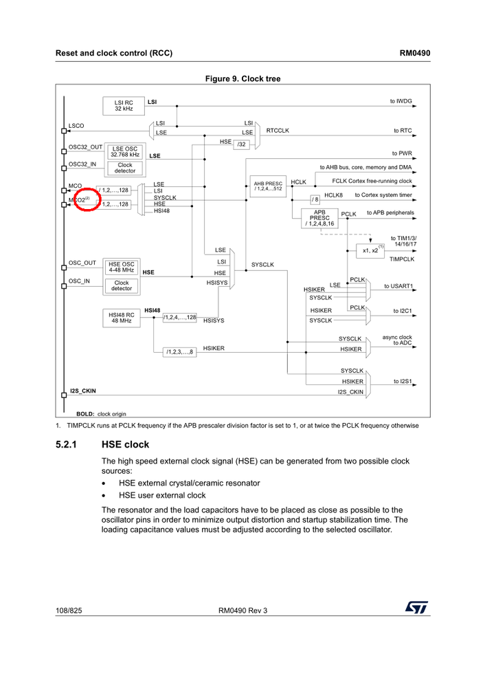

RM0490 ('C0) - missing footnote under Clock tree

Peter BENSCH
Thank you, Jan, for pointing out the typo. Since the STM32C0 were derived from the STM32G0, this is probably a classic copy'n'paste error.
The footnote on the STM32G0 restricts MCO2 to certain derivatives; on the STM32C011 and STM32C031, MCO2 is currently always present.
Regards
/Peter

Hello @Community member​,
An internal ticket ID 145417 is submitted in order to correct the doc.
(PS: Internal ticket number 145417 is not accessible or usable by customers).
Thanks for your contribution.
