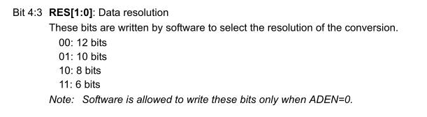

Hi @Kraal ,
We agree that statement is unclear, but it is explicit in Resolution section as well as in bitfield description:
So, the proposition is to add a line in 13.4.4 to exclude RES from this register list to configure once ADEN=1.
Note that the last change for RM0091 was since 2017. Therefore, I will request to update this RM and take into consideration your reported typos.
For this post (since 2017) RM0367 (STM32L0x3) discrepancies related to the STM32L0 series: the reported errors (before December 207) are taken into account in the RM0367 Rev 6 (published in December 2017).
So, I will request also to review and update this RM, to correct the typos that have not yet been corrected.
Thanks for your contribution. All your feedback are welcome in order to improve our documents.
Imen
2021-04-07 4:43 AM
@Community member correct, after reading again the registers section of the ADC chapter, it is almost always said that the modification of bit nn must be done when ADSTART = 0 (so no ongoing conversion). Obviously ADSTART = 1 is only possible when the ADC has been enabled before.
So with the exception of the RES bits, I believe that ADEN must be set before configuring the ADC.
As said before, I never had any issue doing otherwise, but you never know what could go wrong with the details.
@Imen DAHMEN I would suggest an additional snippet at the end of the RM with a configuration of the ADC so that it should be impossible to misunderstood.
