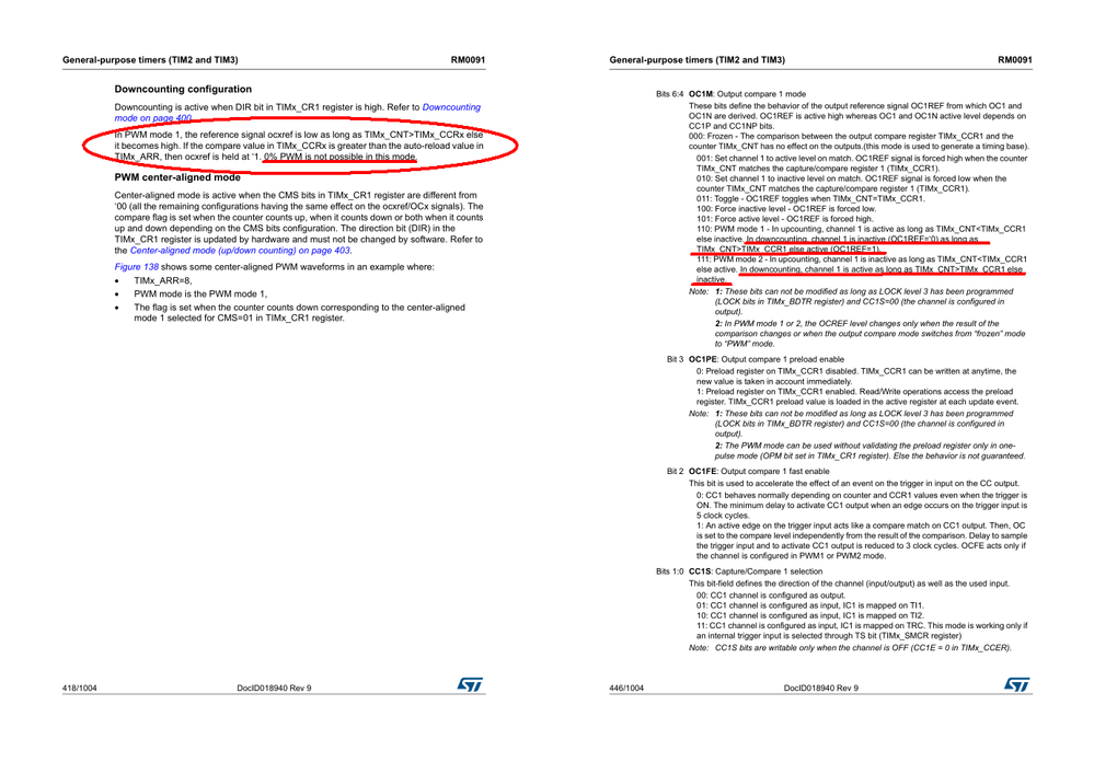

We are well into development of a board at work using an STM32F072RBT6 MCU. I just wrote a quick from scratch test using a NUCLEO-F072RB board to verify things. I'm not sure of the exact problem, but it appears TIM2 is adding 1 to the CCR. I have the timer configured that each count is 1 us, using PWM mode 1, and down-counting. If I write in a CCR of 0, I get a 1 us pulse. If I write in a CCR of 1, I get a 2 us pulse. If I write in a CCR of 2, I get 3 us pulse. You get the picture. I attached the demo project as a zip. I also setup TIM1, but used up-counting and it works as expected. main.c has some comments in it.

> I don't understand why.
Because this is how the timer is designed. This behaviour is documented in RM:
2021-04-16 9:04 AM
OK. So TIM2 I had set for down counting and TIM1 for up counting. The "error" I am seeing is being caused by down counting, but I don't understand why.
2021-04-16 9:32 AM
2021-04-16 9:38 AM
Exactly
2021-04-16 10:50 AM
Wow, ok. Thanks for clearly pointing that out. What I am trying to come up with is a native way to perform right edge aligned PWM and this is what I came up with. Any advice on the proper way of doing this would be much appreciated.
