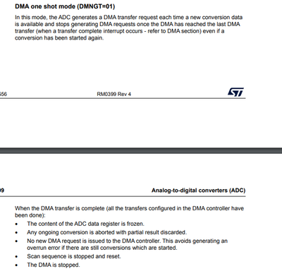

I've tried those steps and I agree they seem sensible for the DMA end. However, it seems like the ADC is still stopped after the end of the transfer and no more DMA requests are being generated.
The reference manual shows the following with no mention of how to restart the ADc for a second one shot sequence.
