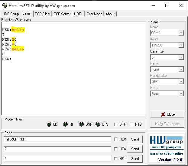

I would expect 7, not 0.

I modificate this function:
void UART5_IRQHandler(void)
{if (LL_USART_IsActiveFlag_RTO(UART5)) //check RTO uart
{ LL_USART_ClearFlag_RTO(UART5); //delete flagreceive_char=DMA_RX_BUFF_SIZE-LL_DMA_GetDataLength(DMA1, LL_DMA_STREAM_0);
itoa(receive_char
, buffer, 10); usart_puts(buffer); usart_puts(''\r\nNEW:'');LL_DMA_DisableStream(DMA1, LL_DMA_STREAM_0);
LL_DMA_SetDataLength(DMA1, LL_DMA_STREAM_0, sizeof(dma_rx_buff)); LL_DMA_SetMemoryAddress(DMA1, LL_DMA_STREAM_0, (uint32_t)dma_rx_buff); LL_DMA_EnableStream(DMA1, LL_DMA_STREAM_0); }}And when I send first string, MCU return good value (7), but after this it is return only 0. And it is wrong value. Any idea, what is wrong?
Yellow: data from PC
Black: data from MCU

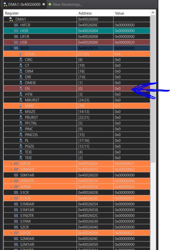

Ok. So I look on register of DMA1 and I see one problem. Register:
DMA_SxCR_EN
isn't set to 1, when I restart my DMA. But I don't know why.void UART5_IRQHandler(void)
LL_USART_ClearFlag_RTO(UART5);prijatych_znaku=DMA_RX_BUFF_SIZE-LL_DMA_GetDataLength(DMA1, LL_DMA_STREAM_0);
itoa(prijatych_znaku, buffer, 10); usart_puts(buffer); usart_puts(''\r\nNEW:'');LL_DMA_DisableStream(DMA1, LL_DMA_STREAM_0);
LL_DMA_SetMemoryAddress(DMA1, LL_DMA_STREAM_0, (uint32_t)dma_rx_buff); LL_DMA_SetDataLength(DMA1, LL_DMA_STREAM_0, sizeof(dma_rx_buff)); LL_DMA_EnableStream(DMA1, LL_DMA_STREAM_0); // this setDMA_SxCR_EN (problem!!!?)
LL_GPIO_TogglePin(GPIOB, LL_GPIO_PIN_14);
asm(''NOP''); //only for debugging
}}But you can see in function, that I set this register.
