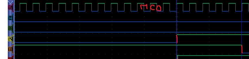

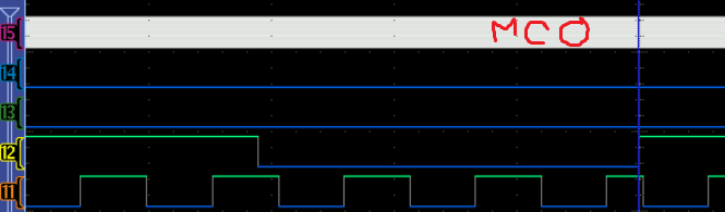

Okay, I was able to get this working. Some of the relevant code:
TIM_SlaveConfigTypeDef slave_config = {
TIM_SLAVEMODE_RESET, // TIM_Slave_Mode
TIM_TS_ETRF, // TIM_Trigger_Selection
TIM_TRIGGERPOLARITY_NONINVERTED, // TIM_Trigger_Polarity
TIM_TRIGGERPRESCALER_DIV1, // TIM_Trigger_Prescaler
0};
HAL_TIM_SlaveConfigSynchronization(info->handle, &slave_config);
The reset occurs 5 clock cycles after the trigger actually occurs, which I can live with.
