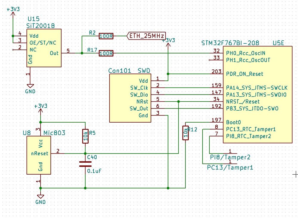

I had a similar issue on my board, until I found the Can Rx pin has to be pulled up..
usually the driver chip does that, but if the canbus drive chip is not installed, without the pullup, it will hang the processor...you can comment out the MX_CAN_Init(); from CubeMX : this fixed my reset-hanging issue.
oooo, yes,,, and I added a reset chip !
