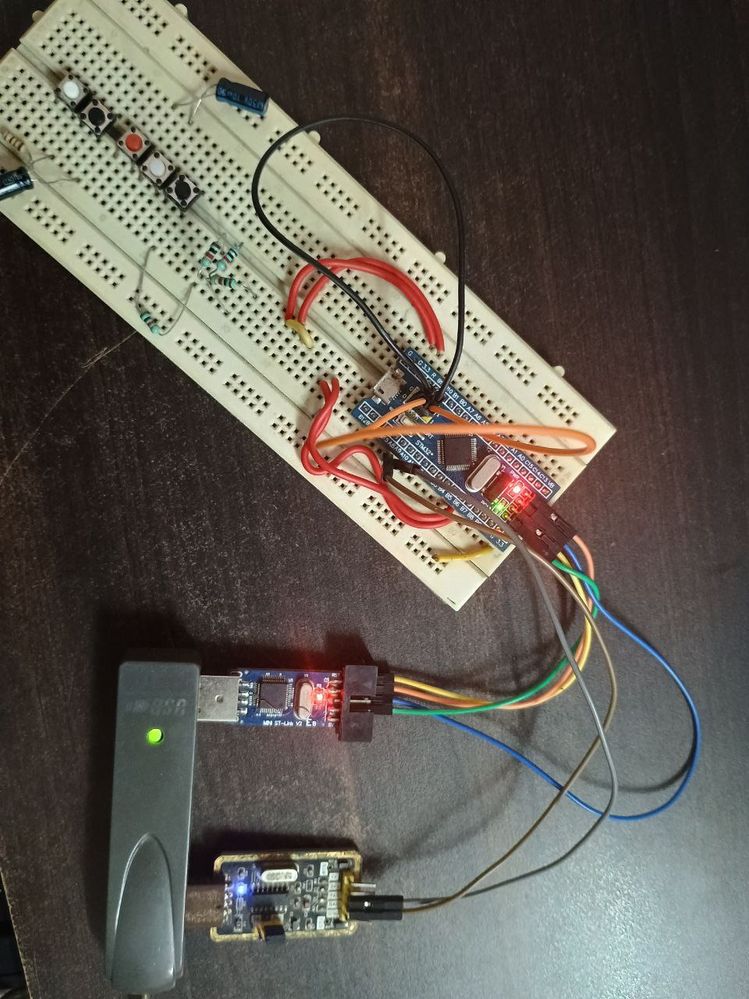

2024-10-04 3:22 AM - edited 2024-10-04 3:22 AM
@Shaktimayee wrote:
I am not using any board. For uploading through ST-LINK i am using a ST-LINK V2 clone.
Your MCU STM32F103RB is soldered on which PCB then? Could you please share a photo of your setup?
Are you using blue pill board?
2024-10-04 3:30 AM
The above picture is my setup.
2024-10-04 3:38 AM
Ok,
I had a doubt you are using Blue pill board: https://stm32-base.org/boards/STM32F103C8T6-Blue-Pill.html
and you confirmed it.
At this stage, I can only suggest you (as I mentioned previously) to check reset pin level according to the user button state. If it doesn't present issue, so I suspect you are facing a fake MCU. So I recommend you to purchase a genuine product such as NUCLEO-F103RB board.
See for example this thread.
