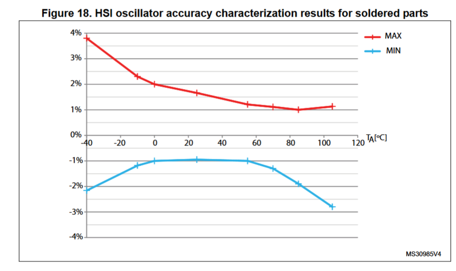

Correct UART communication requires the transmitter and receiver clocks differ by less than 5% (2.5% per MCU), otherwise communication errors may occur. For the temperature range TA = 0 to 85°C the Accuracy of the HSI oscillator is good enough. But for temperatures below 0°C, the HSI has too less accuracy.
What do you do?
I'm assuming that the other isn't at 85C and both likely track in the same direction not polar opposite. ie a share experience not a combined one.
Use two crystals (same part#), again experience will be shared, but deviation tighter.
The boot loader uses USART RX pins connected to a TIM channel to time a test pattern, and set baud rate, I'd perhaps use that to trim BRR high or low. The design is awful here, the dividers were designed by a college intern...
Based on the design I'd estimate you've got a least +/-6.25% on the USARTs
