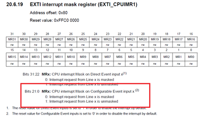

Make sure the EXT preemption priority has the same level for all buttons + use EXTI interrupt mask register to mask/unmask the interrupt:
