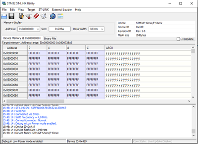

Hello @AGond.2 ,
I made some tests with STM32F429I-Disco board using a ST-LINK Utility and I didn't find any issues as shown in the below figure.
Could you please try the firmware update.
