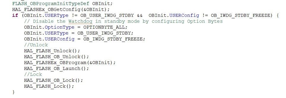

The problem is that the program will always go into the loop as USERType will never be only OB_USER_OWDG_STDBY. Step through the code to understand what it's returning here. The rationale is fine apart from this faulty check.
To recover, connect under reset in STM32CubeProgrammer, or hold BOOT0 high during reset to boot into the bootloader, then connect and recover.

Upon an option byte programming failure for any reason, the mismatch values of the option bytes are loaded after reset. Those mismatch values force a secure configuration that might permanently lock the device.
Please connect your board to STM32CubeProgrammer in "Under reset/hardware reset" mode, in OB/User Configuration, check the values of nBOOT_SEL, nBOOT1 and nBOOT0, you can either use the OB or the physical BOOT0 pin to configure the MCU to boot from system memory.
After the boot configuration completes, configure the RDP level to Level 1 (0xBB). Disconnect the board and reconnect.
Then do a regression to set the RDP to Level 0 again to perform a full mass erase.
If this procedure still can't recover your device, the MCU is locked and can't be recovered.
As for the flash option byte programming, please refer to and follow exactly the steps in chapter 3.4.2 of RM0444.
https://www.st.com/content/ccc/resource/technical/document/reference_manual/group0/2f/21/cb/33/78/80/42/64/DM00371828/files/DM00371828.pdf/jcr:content/translations/en.DM00371828.pdf
There are some problems in your code, HAL_FLASHEx_OBProgram() in STM32CubeG0 is provided to perform the OB programming. Please follow its implementation.

Actually the main issue which we are facing is to connect the MCU using STM32CubeProgrammer. We have tried all the possible reset options and at various frequencies but couldn't get it connected.
It seems that MCU is locked.
Thanks for the STM32CubeG0 repository. I will look into it for a safer implementation.
