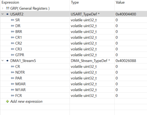

2023-04-12 1:30 AM - edited 2023-11-20 8:31 AM
stm32 f407
I don't know if the image is clear, but all the registers are empty

Being all zero suggests the clocks aren't enabled when looking at them.
For RX make sure all noise, framing, parity errors etc are cleared first.
Check that polled RX works, has to be properly receiving.

If all the UART registers are zero, Tx can't work. It means, you've read out the registers content while UART and DMA were not set up yet - just after reset, perhaps? That's not useful.
Read out the registers after they've been set up, and then again after some characters have been sent to Rx; check, compare, post.
