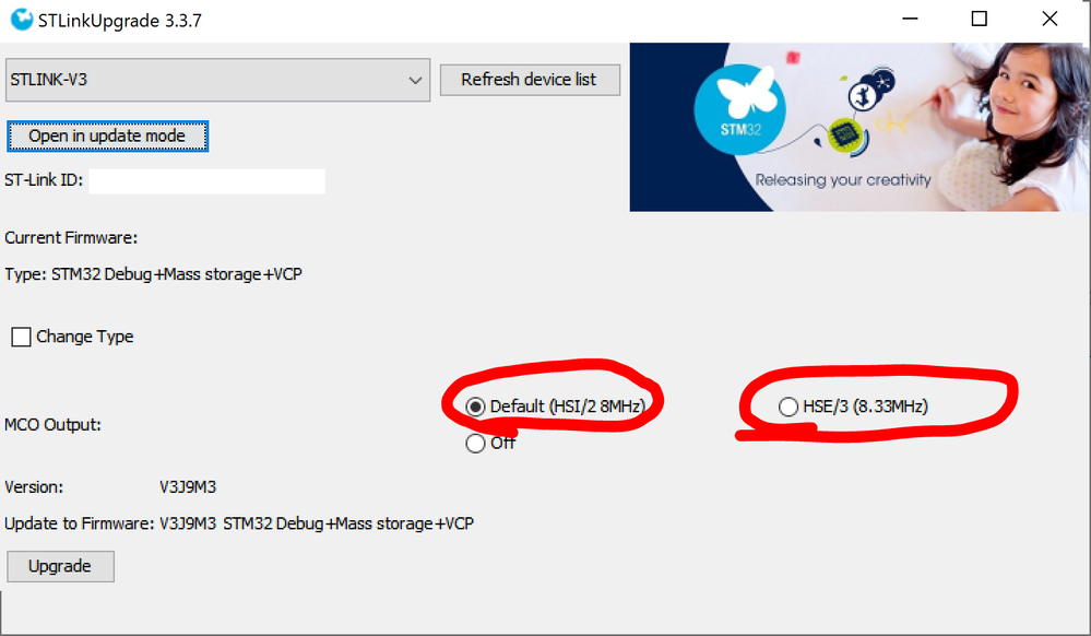

2021-12-14 6:17 AM
The clock that the ST-Link provides the chip is configurable on these boards. During ST-Link upgrade, you can select from HSI-based 8 MHz or HSE/3 (8.33 MHz).

2021-12-14 7:08 AM
Ah, right. I didn't notice that when I first plugged the board in and it wanted to upgrade ST-LINK. I'll have to think about 8.33MHz. It doesn't really play too well with multiples of 48kHz for audio, but I may find some appropriate PLL settings. Thanks for the tip anyway.

2021-12-16 4:38 AM
You can place an extra quartz on the X3 footprint.
You have to set 2 capacitor and move some solder drops.
Refer to the avalable board schematics.
