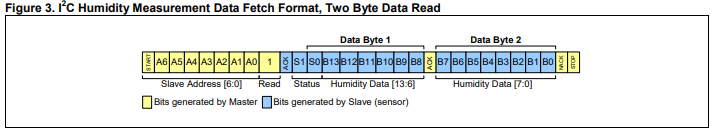

Hello. I have the following scheme for reading the output of humidity sensor that communicates via I2C:
How would I execute this sequence with STM32CubeMX IDE and HAL libraries? The output of the sensor is as follows:

2020-06-05 8:53 AM
val = ((int16_t)(buf[0] & 0x3F) << 8) | ((int16_t)buf[1] );
if (val & 0x2000) val |= 0xC000; // Sign Extend

2020-06-08 1:25 AM
This seems to work, although the final measurement value is a bit off from what we have in the room. Could You explain, what You did with the first line of code? Thank You very much
2020-06-08 2:45 AM
Especially, where is the 0x3F byte from? What would happen, if I Would change its value?
2020-06-11 12:07 AM
It should be noted that these separate write+read operations put stop-start bit sequence in the middle. HAL_I2C_Mem_Read() can do a complete sequence, but it works only with memory/register addresses. HAL has those "Seq" functions - probably you can cobble it together with that crap. But all of this is ridiculous for a "high-level" library...
