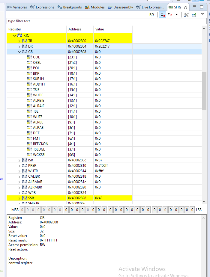

> I read continuously the RTC time
How exactly?
Are you aware of the RTC_CR.BYPSHAD bit and that if it's cleared, you have to read RTC->DR after you've read RTC->TR? Read Reading the calendar chapter in RM.

Yes, I dont perform any change to RTC_CR.BYPSHAD bit so I suppose that this uses the deafult value which is cleared, however, I was looking to check this by using stm32ide with SFRs view tool, but the bit is not including here, however, the total register is showed and this effectivly is cleared. I attach the picture.
I am using the HAL library to get the time, so I assume it is correct. Here de code:

2020-02-17 1:06 PM
That is, I was just reading time without read date, now for each time reading operation I make read date operation and this solve the problen.
Thank you very much.
