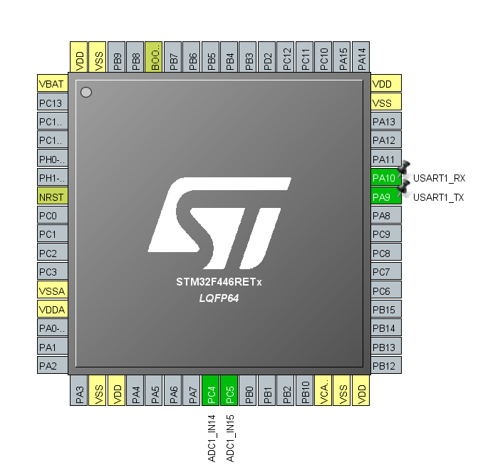

I'm new to working with STM32's so if I make any mistakes please let me know. I have the STM32F446RE Nucleo board and I'm trying to read two ADC channels (IN15 on GPIOC_05 and IN14 on GPIOC_04) and output the ADC values over USART 1 channel as fast as possible. I set my board up in STM32CubeMX and I'm editing in uVision 5. I'm think I'm reading the two ADC channels correctly but having trouble passing them out over USART1.
