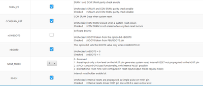

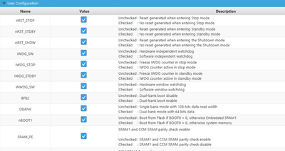

Dump FLASH_OPTR / 32-bit word at 0x1FFF7800

Dump of FLASH_OPTR:
