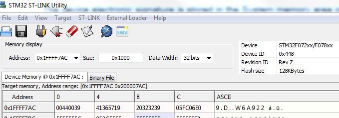

Hi Pares,
I have made a quick test using ST-Link utility to read the address on STM32F053B-DISCO and it is successful.We’re moving the ST Community to a new platform to give you a better and more reliable community experience.
