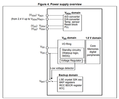

By entering standby mode, the main VDD supply is powered off ( the 1.8 V domain is consequently powered off), and RTC and backup registers are retained because they are powered from the VBAT as shown in the figure:
>>So that means the LDO is not actually switched off as it doesn't detect VDD to be lost or lower than the threshold.
Switching to the VBAT supply is controlled by the power-down reset (PDR) circuitry embedded in the reset block, which is always active. When VDD drops below a specified threshold, the device remains in reset mode (check datasheet and AN2629)
So if the VDD is active, the switch of the VBAT will not occurs, and the LDO is continue to supply the RAM, is it right?
Yes, there is no need to retain contents of backup registers (switch to VBAT) when VDD is ON
>>All the data in the RAM all still keep the values.
What you're seeing is a latched state of RAM prior to VDD loss, however, this is not reliable as these values can vary with temperature, different environment... So, we cannot guarantee the state of RAM data.
