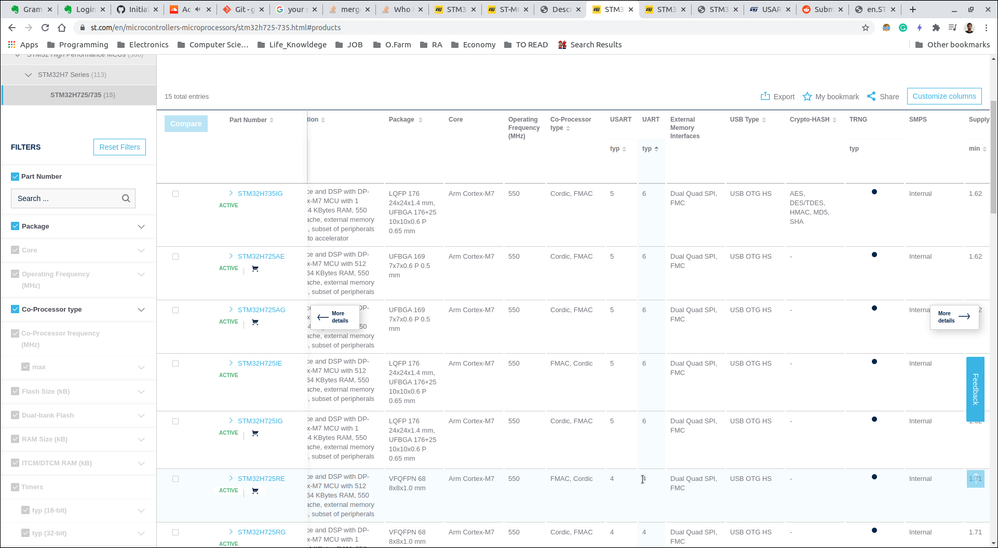

I did check the reference manual, but it was not stated. I have also seen in an image the same core has different counts of UART. Hence I am a bit confused.

I am about to compare the available number available of UART/USART of the same family. Look like currently, I'll have to open the datasheet of each interested MCU's datasheet to findout. No other tool to help out to compare among the family?
