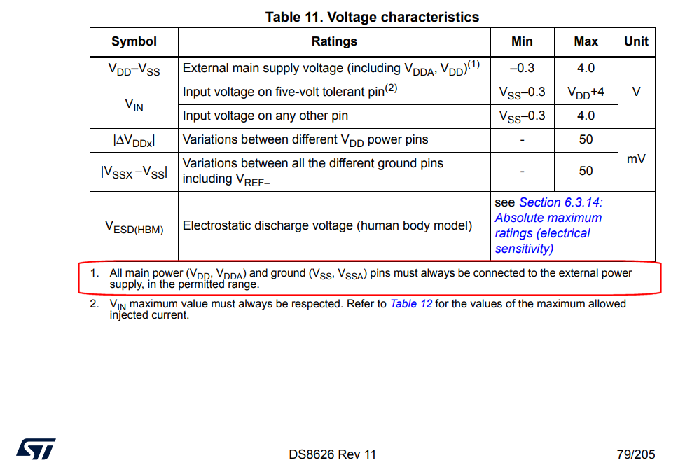

2026-03-19 3:41 AM - edited 2026-03-19 4:30 AM
@OLAMIDESET wrote:I'm making a custom-built board and want to clear any doubts before powering it up..
The instructions given are clear: When designing a PCB, you must ensure that all VSS pins are connected, and all VDD pins are connected - no room for any doubts in that!
https://www.st.com/resource/en/datasheet/stm32f407zg.pdf#page=79
