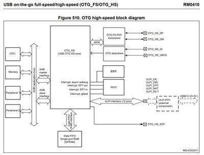

STM32F767 MCU has two USB 2.0 device/host/OTG controllers as stated in the reference manual. The first is a full-speed controller with an on-chip FS PHY. The second is a full-speed/high-speed (FS/HS) controller that integrates the transceivers for FS operation and features an ULPI for HS operation.
However, to use the HS operation, an external HS PHY connected to the ULPI is required. This means that the speed (FS or HS) depends on the configuration of the MCU and not on the host device.

Thanks, I cannot find the datasheet with your diagram above, but looking at the datasheet here ( https://www.st.com/resource/en/datasheet/stm32f765bi.pdf ) I can see it mention an external PHY. From the datasheet it looks like none of the nucleo boards support USB 2.0 HS though ( https://www.st.com/resource/en/user_manual/um1974-stm32-nucleo144-boards-mb1137-stmicroelectronics.pdf )

Hello @Smashcat
The diagram is extracted from RM0410 to specify the controller's features and specifications.
For the implementation, you refer to user manual of boards as you mentioned.
