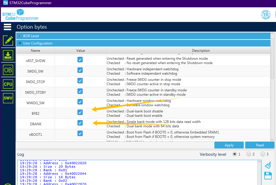

A test program for LED flashing has been successfully constructed in the IAR environment.
Use STM32CubeProgrammer to load BANK1 starting from 0X8000000, DBANK=1,BFB2=0, and the program runs OK

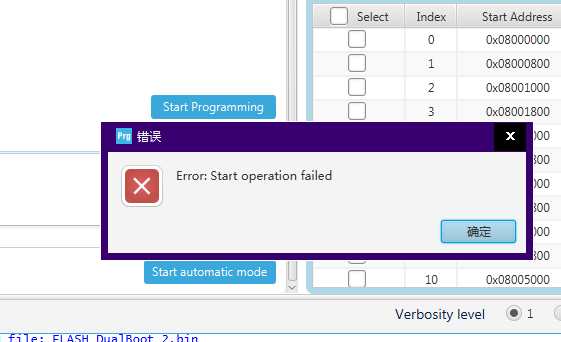

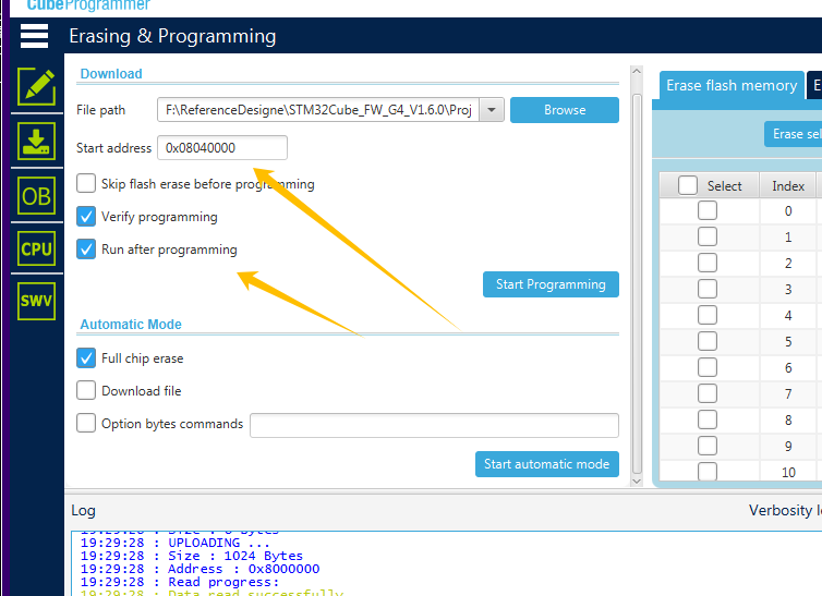

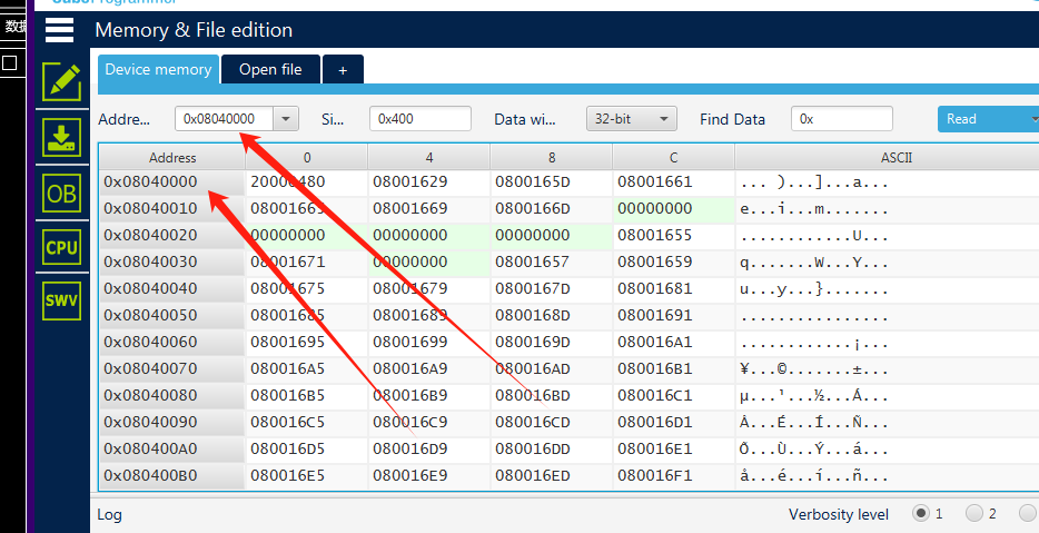

When BANK2 starting from 0x8040000 is loaded, DBANK=1 and BFB2=1, the program cannot run
May I ask to see if there are any problems with my application Settings

Both banks will be swapped with BFB2=1 and all addresses from BANK2 will be remapped to BANK1 (and vice versa).
Otherwise the flash addresses, generated by compiler, would all be wrong. So the start address for booting from BANK1 (BFB2=0) and from BANK2 (BFB2=1) also stays the same virtually @0x08000000.
