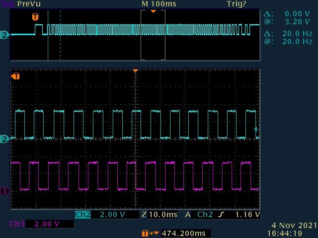

> What's the signal source, does it have clean edges?
The signal from the encoder looks good, clear transitions.

Did you check the waveforms - directly on the pins - when the failure occurs?
