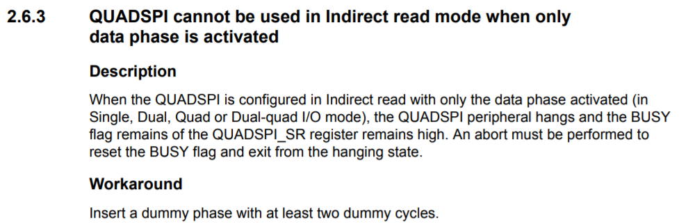

2019-09-24 11:43 PM
Check errata sheet ES0392, Rev. 6, 2.6.3.
2019-09-24 11:43 PM

2019-09-25 10:30 AM
Wow! Thank you so much for 100% accurate answer! Now it is clear.
I will leave it here for the future:
