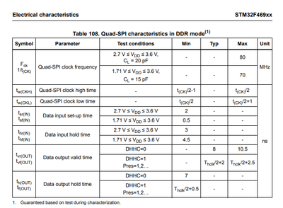

To configure QSPI in DDR mode you mainly need to:
-Disable SSHIFT by using QSPI_SAMPLE_SHIFTING_NONE instead of HALFCYCLE => this is a must for DDR mode.
- Enable DDR mode with QSPI_DDR_MODE_ENABLE
Also, please not forgot to change the right DTR read command, the dummy cycles value required by the memory for that DTR mode (please refer to memory datasheet) and to re-configure the prescaler to get the correct QSPI speed to support the QSPI DDR mode mentioned in the STM32F469 datasheet and to support the memory datasheet as well.

A thorough understanding of the data sheets and reference manuals is also recommended paying particular attention to timings and dummy cycles and there relationship to higher frequencies.
