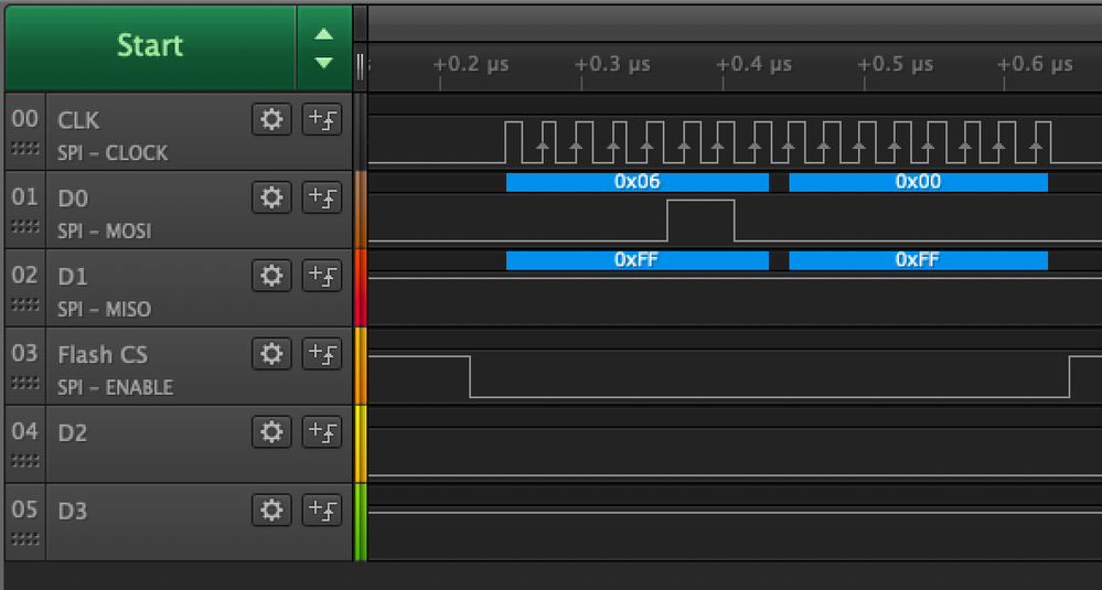

hqspi.Init.DualFlash = QSPI_DUALFLASH_DISABLE;While I can read from the registers just fine (which otherwise indicates the connections and configuration is sound) here's what shows up on my scope when I issue the write enable command. An extra byte is sent before CS goes high again, which I believe is causing the write enable command to fail. I know it fails because subsequent register reads via auto-polling show the write enable bit has not latched. I've been at this for hours and cannot find a way to just sent a single instruction byte!

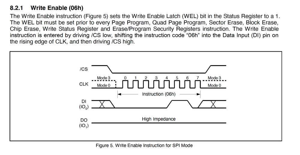

The flash datasheet (Winbond W25Q128JV) clearly specifies that the write enable command should be 0x06 bounded by CS transitions

Even configuring the command as QSPI_INSTRUCTION_NONE with QSPI_DATA_1_LINE then trying to manually send the 0x06 as a 1 byte transfer with the HAL_QSPI_Transmit function just sends those in reverse. It's like the HAL_QSPI_Command function is determined to send a byte of 0x00 no matter how it is configured. Really hoping this can be answered by someone.

Can you please be a little more specific as to what you think I'm missing? My command configuration explicitly disables the address, alt bytes, dummy, and data parts of the message. According to that video (and the documentation that it references, that I've already read) I should be able to just send a one byte instruction by disabling the other parts of the message. I am configuring the options to do exactly that, but I'm still getting two bytes out instead of one.
2020-10-03 1:30 AM
Check for BUSY or TCF flag in QUADSPI_SR to wait for command completion, read QUADSPI_CCR and inspect every single bit according to RM.
There is certainly something configured incorrectly. Don't trust HAL (or any other software) to do exactly what you *think* it does.
