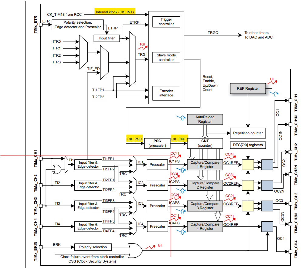

2021-01-19 1:33 PM
Thank you Tesla for the precise answer.
Would please confirm that if I am using the TIM1 the external clock is the same as APB without a Prescaler?
In the reference document, ST calls the clock an internal clock. I am using an external clock, the APB2 90Mhz clock.
How I do verify that I am connected to the external clock?
Please see the picture attached to this post.
Thank you in advance,
S.Tarik
