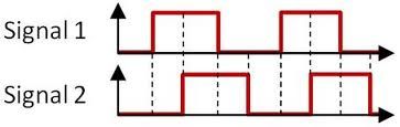

It gives a PWM with
50% Duty Cycle
I want to shift time of this signal like this
I have already Signal 1 i want to create Signal 2 shifted by period T
Wh
at
parameter have
i to change ?
Thank you

I see that the signal change In PWM1 mode it begin with 0 value then 1 ... But in PWM2 mode it begin with 1 value then 0 .... Are there another mode that i can shift the signal with specific time ?2013-03-19 9:32 AM
Any help please ?
2013-03-19 9:53 AM
Not sure you can do this with a singular timer. You could presumably use two timers, and adjust the relative phase by changing the value of CNT with respect to each other.
