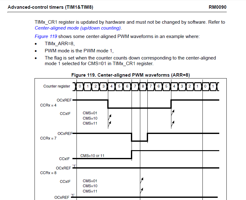

2017-10-25 5:46 AM
Hello!
htim1.Init.CounterMode = TIM_COUNTERMODE_UP;
Try to use the center-aligned mode by replacing the mode with TIM_COUNTERMODE_CENTERALIGNED1.
Take a look also insid RM for different PWM modes.
Regards

2017-10-25 9:01 AM
THATS IT !! Channel 2 is centeder using 'TIM_COUNTERMODE_CENTERALIGNED' THANKS A LOT! now i have to check which one I must use from 3 modes of center aligned.
Apart from that, also obviously the frecuency decreased to the half, so I have to recalcule the timer, but thats easy...
It was my fault becasue i should have readed the reference manual.
