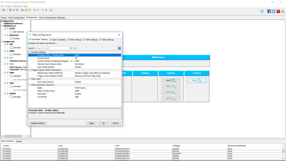

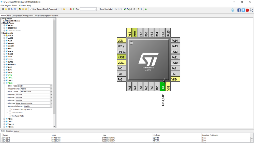

Hi, you can do this work in this way: in the stm32cubeMX you set this settings :
you can set your duty cycle and other settings in this way :
with this settings , we have 50% duty cycle with 1Hz frequency . after generating your project :
you can start your pwm in this way :
HAL_TIM_PWM_Start(&htim3, TIM_CHANNEL_4);
<write this on top of while(1) >
you can change your duty cycle with
__HAL_TIM_SET_COMPARE(&htim3,TIM_CHANNEL_4,3999);
its all thing that you should do .
