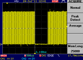

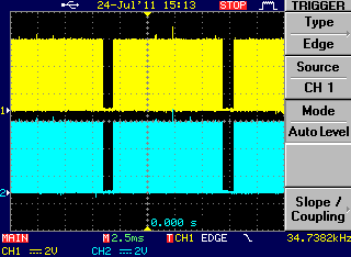

Here can you seen that the signal is quiet in for a millisecond
