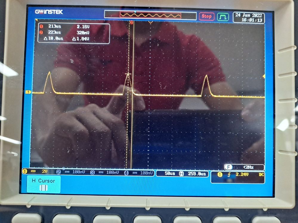

I am using STM32f051c6t6. I am using internal crystal clock source. I have also set Timer clock source to 24 MHz. I am writing simple program to generate low and high pulse. The 10 us pulse is not generated properly. The rise and fall times has delay of 10us which is unexpected . What could be the reason ? Could the reason be internal clock source ?

}Below is the image
What is the reason for imperfect pulse ?
Is this the problem in STM32F051C6T6 or could it be other reasons ?

"The rise and fall times has delay of 10us"
What are you measuring this delay relative to?
"Below is the image"
Doesn't your scope have a facility to capture a screenshot? That would be much clearer than a photo!

Check your oscilloscope measurment method (!) or pin load, waveforms have suspiciously "slow" edges. 10us puls with heavy RC loading should look like that you see ! First edge is time when rising start, second edge is time when fall start. That moments are 10us delayed like you expect.
BTW1: Use Timer output to generating precision pulses. Way you are using have jitter (uncertainty) few (or more) CPU ticks.
BTW2: Using internal oscillator, there will be up to 1% frequency (and pulse width) deviation due oscillator inaccuracy.
