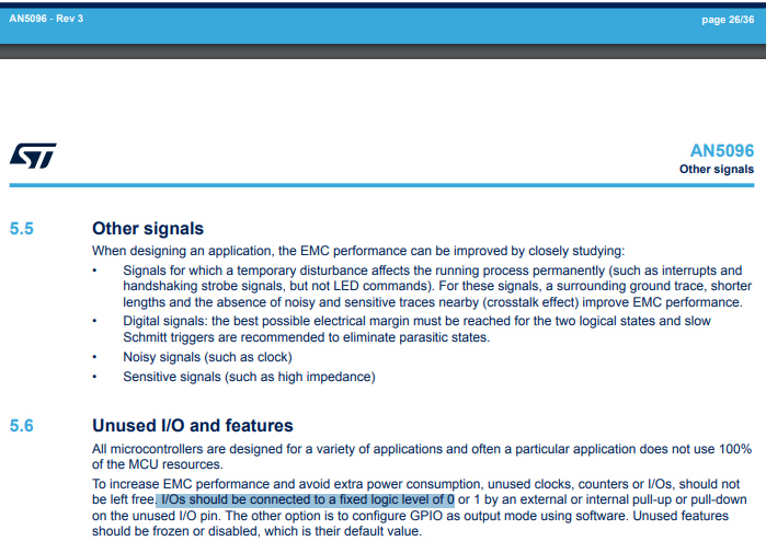

Hello, I’m a bit confused. If I configure PC6 with an internal pull-down, will that resolve the issue? Or is leaving the pin unconfigured sufficient for protection?
To clarify: the product has already been distributed, and I can only make changes via an OTA update. If there’s a way to improve safety by adjusting the configuration of PC6, what would you recommend? Or, as you mentioned, is it better to leave the pin unconfigured?
This leads to another question: could a different pin be causing the problem? I will check PCB design a little bit further then.
Thanks for the help.
