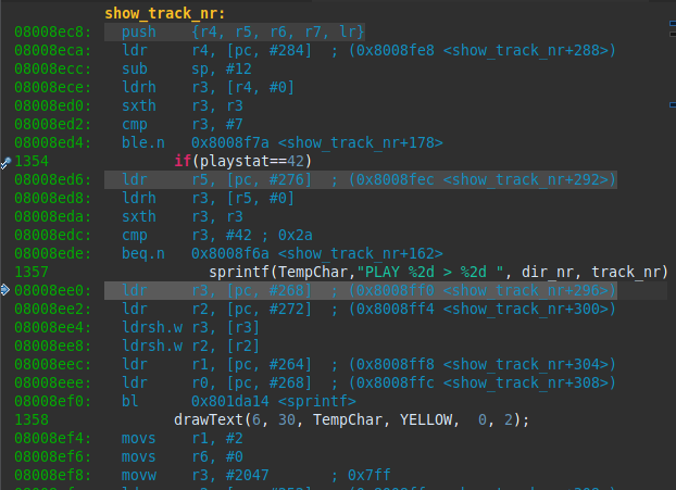

breakpoint reached normal;
from here this jumps to "show.."
and then this breakpoint seems never reached, but when going step by step
line 1354 is reached and also the following "sprintf.." , but it gets curious:
when "Radio.." text is selected , is drawn on TFT and program runs on,
but when"PLAY..." is selected, it never prints and "hang up" in some loop around DMA-INT-busy-ready-DMA...endless. but no hard-fault coming, just busy looping.
+ i did something...probably...because some days before all this working without any problem (since many weeks) and i changed nothing here. just i made some "improvement" in grouping the "chars" and "uint8" together, just for better clarity.
and then tried to improve the ESP web radio program, (-> Radio-ESP active);
just today i found the other "play" hanging up...
i would be happy with any idea, whats wrong here now.
just...this is the asm here:

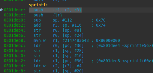

if stepping in the print-to-TFT :
but is there:
I am at a loss.
