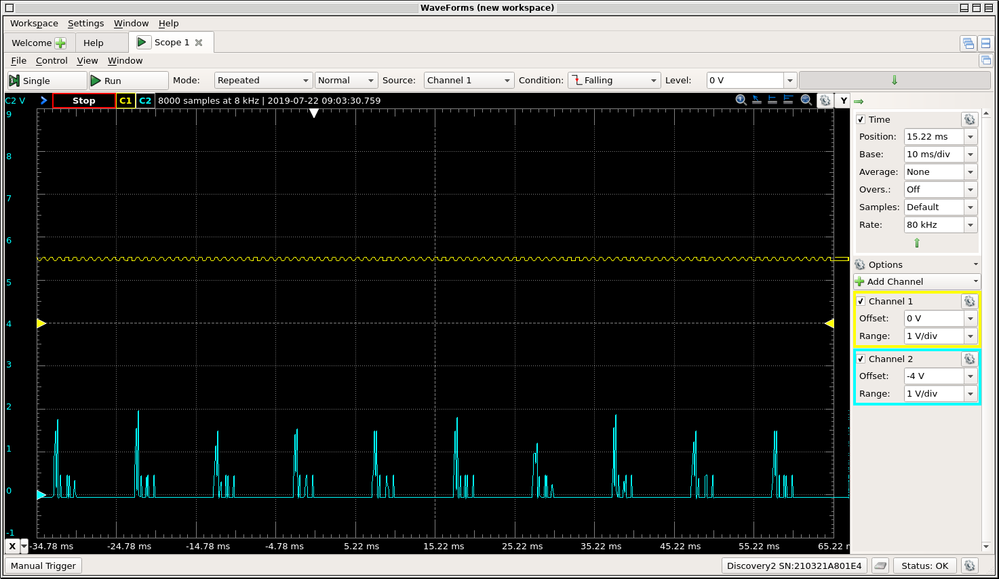

And here is screenshot from my oscilloscope:
where:
This screenshot has been caught while program running. I'm wondering why SCK (yellow) signal still has value about 1.6V and almost doesn't change. I think it should switch from 0V to 3.3V, but it doesn't.

2019-07-22 6:44 AM
Read out and check the SPI registers' content.
What's on the o'scope is alarming, but then we don't know what exactly, and how, do you measure.
Check if there is no conflicting connection on the given pin. Try to wiggle it with a simple code setting it to GPIO.
2019-07-23 1:06 AM
It turned out, that my oscilloscope had bad power supply - it was powered by USB. I fixed it (changed the USB cable) and now the SCK, MOSI ans CS signals are looking properly on my oscilloscope.
Thank you for your rapid answer.
