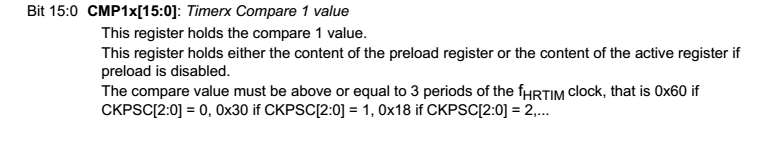

Hey, I think you've missed the minimal of the compare value.
(?from ref man
)Your cmp value should range from 96 (32*3)....
So you may both add this minimal val to your CMPx,
(For example, CMP1 = 0x60, CMP3 = 0x65, then you get a phase shift with 5 HRTIM Ticks)
Moreover, you would probably use an external crystal, for the HSI changes with the temperature.
Good Luck!
