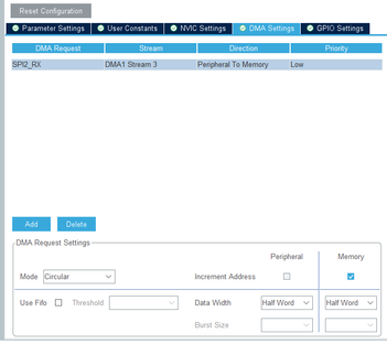

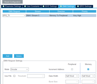

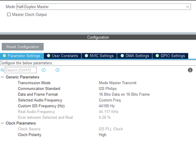

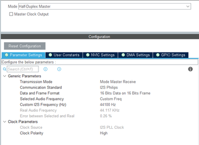

What i am doing now in the ST is only receiving the data and sending it to the MAX. For that i am using a ping pong buffer and the both I2S with DMA in circular mode (all as master):
-Input
-output
The ESP32 sample rate is 44,1kHZ and all the streams are stereo.

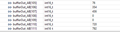

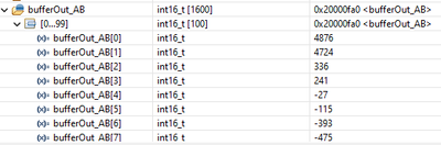

One thing that i notice using a sine wave signal was that sometimes the first 2 numbers are trash and in some random places i have 0 or 1 wich are not okey.
ie:
the second glitch is what i think is causing the noise but i don know how to eliminate those. (Seems to be random places were they appear).
