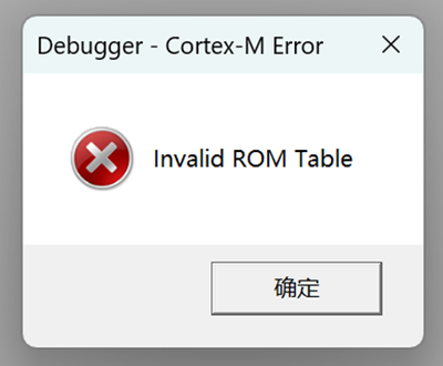

After I opened the project in the Keil v5 and rebuilt the whole program, with no warnings or errors, I found that i can't download my project to the board. It showed an error of "invalid rom table".

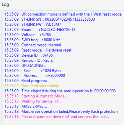

Then I decided to use the STM32CubeProgrammer to erase the whole chip, as I did before when developing stm32h7. I found that the flash size in the target information colums shows "null".
And when I used the full chip erase function, it shows: Mass erase operation failed. Please verify flash protection.
