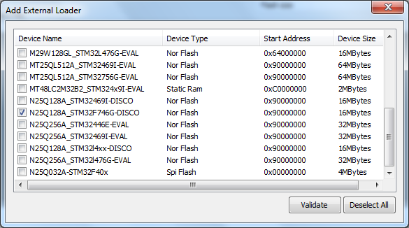

For Keil, you'd need to build a .FLX/FLM driver compatible with your chips
\Keil\ARM\Flash If you can't do that, have Keil generate .HEX, flash with ST-LINK Utilities + External Loader, and then debug with Keil where you uncheck download first options.2015-12-28 7:56 AM

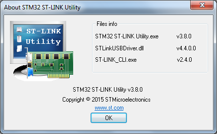

Sounds good but I have no idea, how to go on. In earlier posts you wrote to use the newest ST-Link utility and I could find the utility in version 3.8 on st website but inside it there is a version 3.3 instead of 3.8. Is this a bug!? I dont know how to butild an FLM for this chip. Is anywhere a ready to install version? Thanks.2015-12-28 1:37 PM
The GUI version is definitely 3.8.0, just downloaded and confirmed here.
http://www.st.com/web/en/catalog/tools/PF258168
You have to add the external loader for the N25Q128A_STM32F746G-DISCO to support the QuadSPI NOR device. You'd have to seek support through Keil or ST contact points2015-12-28 1:48 PM
Supposedly a 16MByte device
