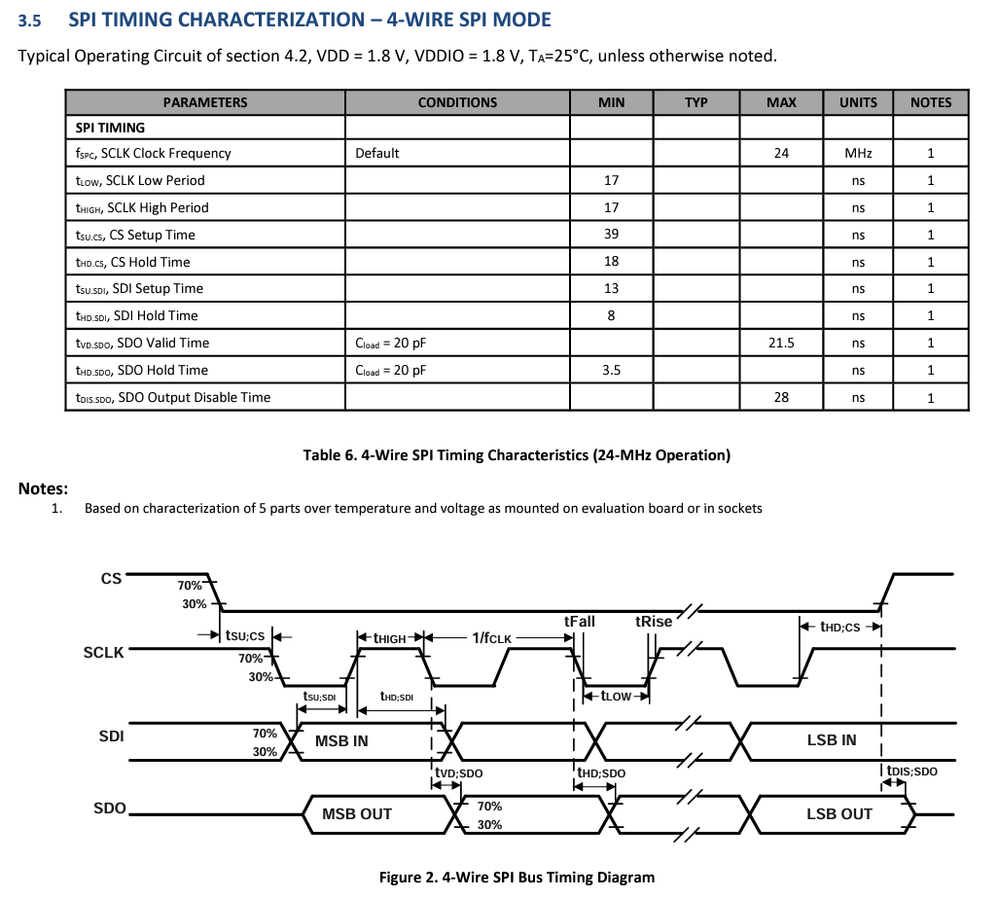

The ICM-42688 Timing data is:
 So CPOL = 1, CPHA = 2 and SCLK ic high in idle.

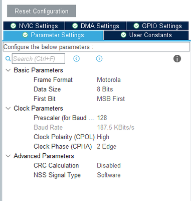

The Device Config is as follows:
hspi1.Instance = SPI1;
hspi1.Init.Mode = SPI_MODE_MASTER;
hspi1.Init.Direction = SPI_DIRECTION_2LINES;
hspi1.Init.DataSize = SPI_DATASIZE_8BIT;
hspi1.Init.CLKPolarity = SPI_POLARITY_HIGH;
hspi1.Init.CLKPhase = SPI_PHASE_2EDGE;
hspi1.Init.NSS = SPI_NSS_SOFT;
hspi1.Init.BaudRatePrescaler = SPI_BAUDRATEPRESCALER_128;
hspi1.Init.FirstBit = SPI_FIRSTBIT_MSB;
hspi1.Init.TIMode = SPI_TIMODE_DISABLE;
hspi1.Init.CRCCalculation = SPI_CRCCALCULATION_DISABLE;
hspi1.Init.CRCPolynomial = 10;
I have it slowed down at present to see if speed is the cause of my problems...

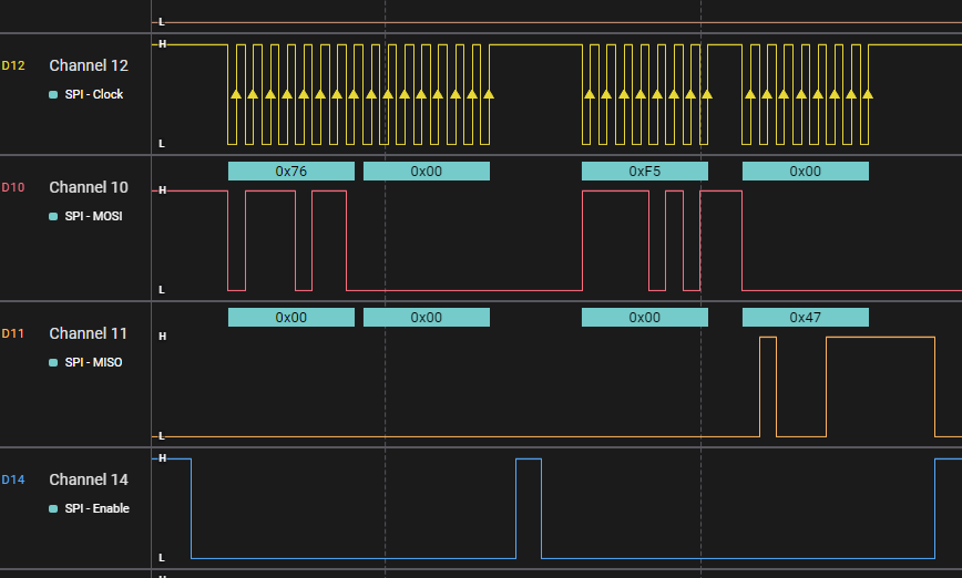

When I monitor the lines with my Saleae 16 I get a good response.
The 0x76,00 is a write to the register 0x76 to select bank 0.
The 0xF5,00 is a read request for the Register 0x75 and it should return 0x47 which is is doing - YAY.
My problem is that the data doesnt seem to be clocked into the STM32F413 chip...
I always end up with 0x00.
I have tried a number of different permutations using HAL_SPI_Read and HAL_SPI_TransmitReceive and none seem to work.

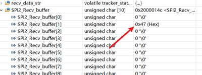

Qingcha
Associate
Hi,speedyPLH.
Using the same parameter(except the baudrate->656.25KBits/s ) in my project that it seems working,you can try my code
void SPI2_TestFunction(void)
SPI2_CS_Enable();
SPI2_Send_buffer[0]= 0x76|WriteOperation;
HAL_SPI_TransmitReceive(&hspi2, &SPI2_Send_buffer[0], &SPI2_Recv_buffer[0], 2, 10);
SPI2_CS_Disable();
HAL_Delay(10);
SPI2_CS_Enable();
SPI2_Send_buffer[0]= 0x75|ReadOperation;
SPI2_CS_Disable();
