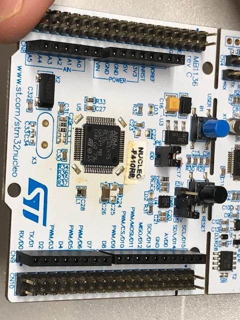

We tried to solder L475re on nucleo board. On the board we see the same situation if we connect GPS module.
Also we tried to connect GPS module to
32
L
476
GDISCOVERY board. In this case all work fine.
We added additional capacitor near gate and this helped to improve step response, MCU works. But the questions is why MCU works incorrectly om 2.5V if it must work down to 1.8V?
