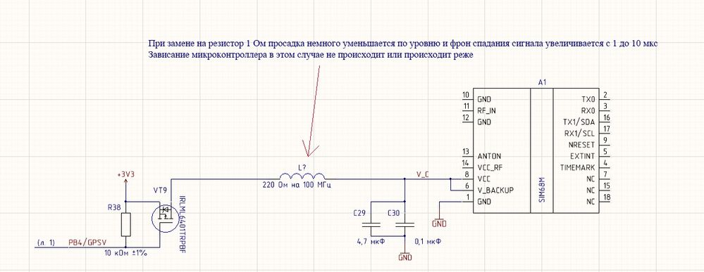

We tried to power MCU & GPS from Laboratory power supply, situatuion still the same.
If we turn on GPS voltage drops to 2.5V. We tried to connect 100 Ohm resistor instead of GPS and in this case all works fine. We tried to use 1 Ohm resisitor instead of L? bead and it helps to lower voltage drop but voltage drop still exists.
2018-03-02 5:44 AM
I would short this coil too, perhaps with a 1..10 Ohm resistor.
If the voltage drop is still too severe, you might consider separating the 3.3V supplies for the MCU and the GPS module.
And perhaps the GPS supply from regulator with an enable input, switched by the STM32, instead of the MOSFET.
Or a hardware guy can suggest a cheaper solution.

2018-03-02 9:34 AM
Not so good with Russian technical terms, but the coil seems to be 100mH.
IMHO at least two orders of magnitude too much.
2018-03-03 3:45 PM
Artem, I would add 1 megohm resistor to the gate of VT9 transistor. This will slow down the turn on slope.
For even slower turn on, add 100nF cap between gate and output of VT9. Adjust R C values to taste.
Peter
2018-03-03 4:47 PM
Using a 0.05 ohm switch to connect a discharged 4.7 uF capacitor to your uC supply is asking for trouble.
Try removing the C29 (
4.7 uF)
capacitor. The module may have additional internal caps.The better solution is the R C modification to the VT9 switch mentioned earlier.
See
https://electronics.stackexchange.com/questions/9307/how-to-limit-inrush-current
Peter
