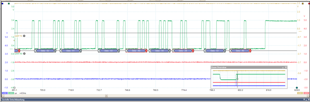

I am using an STM32L4 chip that sends an update to the nRF52832 on a ublox module over USART. I assume the nordic chip is in the bootloader during the update.
We get a UART error: 4 and when we observe the UART lines we see that on the TX line of the nRF the stop bit is not present. I assume the nRF does not pull the line high properly after transmitting a frame. (we do not use pull-up resistors on the USART lines on STM32L4 side)

Bad behavior with missing stop bit:

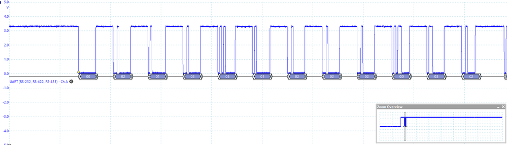

Good behavior with stop bit present:

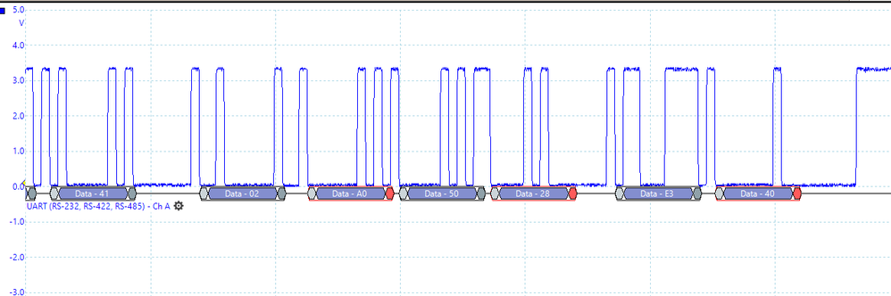

Bad behavior with

2022-05-11 2:54 AM
The problem was the clock setting (low accuracy clock was used probably)
solution is here: https://devzone.nordicsemi.com/f/nordic-q-a/87580/issue-with-updating-nrf52832-over-usart
