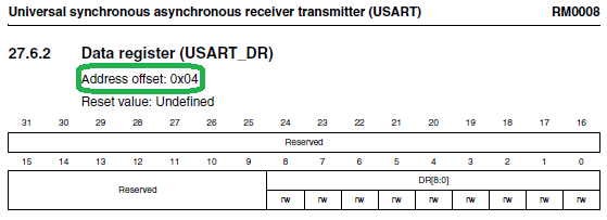

Can you please re-check is there anything wrong?By the way, I do not really understand why(uint32_t)SERIAL_UART + 0x04
not 0x00?2014-05-07 10:16 AM
Ok. Today I tried different codes on my design, just to make sure that is not a UART hardware problem. Everything is OK except the code above. Can you please re-check is there anything wrong? By the way, I do not really understand why
not 0x00?I skimmed through it, didn't see anything awful in there, perhaps not how I'd do it, but as I said I'm not currently doing development work with F1 parts, and I know very little about your hardware. This isn't something I can easily standup and run. Perhaps you should speak to the people who wrote it? The DR (Data Register) is not at the base of the peripheral, it's offset. You could always use &USART1->DR if you wanted some clarity. Review the Reference Manual for your part.
