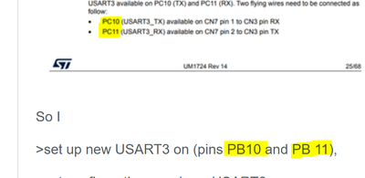

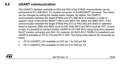

During development of my project on Nucleo-F303RE, I noticed that there is no communication on my Arduino connector USART2 related pins, even thorugh I set it up in the STM32CubeIDE pinout configuration. Quickly I found out in UM1724 that these pins are by default not connected to the ST morpho and ARDUINO connector, due to the connection to ST-LINK MCU.
So I
>set up new USART3 on (pins PB10 and PB 11),
>set configuration exacly as USART2,
>flashed the board
>as in the user manual I soldered OFF 2 bridges (SB13 and SB14) and soldered ON 2 other bridges (SB62 and SB63)
I connected these pins (PB10 and PB11) to the CN3 Tx and Rx pins and I am able to download and debug the code. However, when I try to communicate with the board using putty terminal on COM3 (where the board is connected) with correct baudrate, I no longer can transmit any data from PC to the board and vice versa.

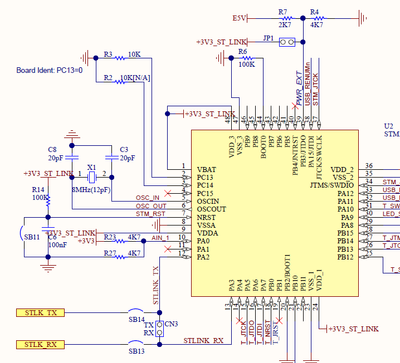

Hello @Aster ,
I think you have mixed several things here.
1/ Usart2 is connected by default to ST-link and is getting used for code downloading. You have nothing to modify by default to work with.
If you want to use usart3 instead of usart2 to be connected to stlink then you have to do the following :
CN3 is here to indicate that you can use uart3 as stlink .
2/ BUT in your case, you want to use usart3 to communicate with an external tool (putty)

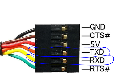

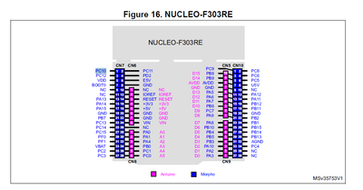

If you want to use UART3 to communicate with an external tool like putty you have to connect your pc with a USB/RS232 ftdi cable to pin PC10(TX) and PC11(RX). And not CN3.
be careful with the TX/RX cable and don't forget GND cable.MikaelM_4-1697803696643.png

I thought that there is no difference between using different USART3 pins on the board as long as they are connected properly with the CN3. However, when I changed their position from PB10 and PB11 to PC10 and PC11 it started to register the incoming data via HAL_UART_Receive_IT and HAL_UART_RxCpltCallback, but incoming data is pure gibberish. It looks like when I send data over putty terminal to the board it populates my buffers with random data. Here is checklist of things that I have looked at to solve the problem:

Isn't one of the issues here that the NUCLEO-64's generally combine the ST-LINK and Arduino shield comms on a single UART and you want them separated.
I'd likely disconnect the bridges and then route an alternate / available UART RX/TX pair to the CN3 points.

It tourned out that all of these problems and abnormal behaviours were caused because of shorting of SB13 and SB14 bridges. After carefull investigation of schematic I was 100% sure that I am doing everything right in code and in hardware. I didn't notice this issue at first because it was really small solder leak.
Thanks again for all the asnwears - especially @MikaelM for sharing the schematics which brought me closer to the solution.
