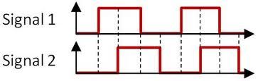

exuse me but i don't see any difference betwen signal using
TIM_TimeBaseStructure.TIM_ClockDivision = TIM_CKD_DIV1
TIM_TimeBaseStructure.TIM_ClockDivision = TIM_CKD_DIV2
TIM_TimeBaseStructure.TIM_ClockDivision = TIM_CKD_DIV4
It gives the same signal in my oscilloscope
How can I change
TIM_ClockDivision to shift time signal please
