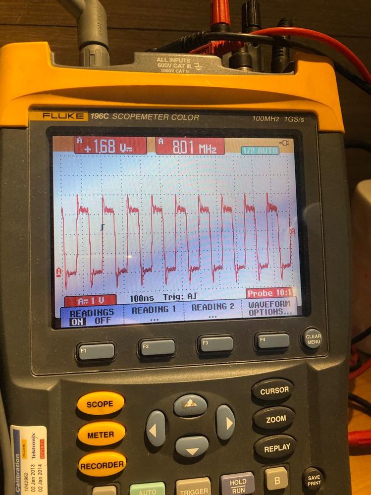

2022-09-14 2:39 AM
I have just tried with an old mcu buy in 2021 from another provider. It seems ok, 8 MHz ! Of course, I am using exactly the same code to test the mcu.
An idea why some mcu have a defect clock ?
2022-09-14 2:48 AM
Hello @Nikita91,
The code is right :) This line compute the prescaler to get 10kHz as counter frequency. Then, 800 is not the the clock frequency but the prescaler value. That means 8000000/(PRESC+1) = 8000000/(799+1) = 10kHz.

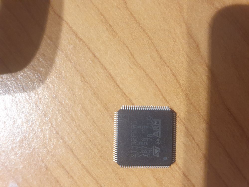

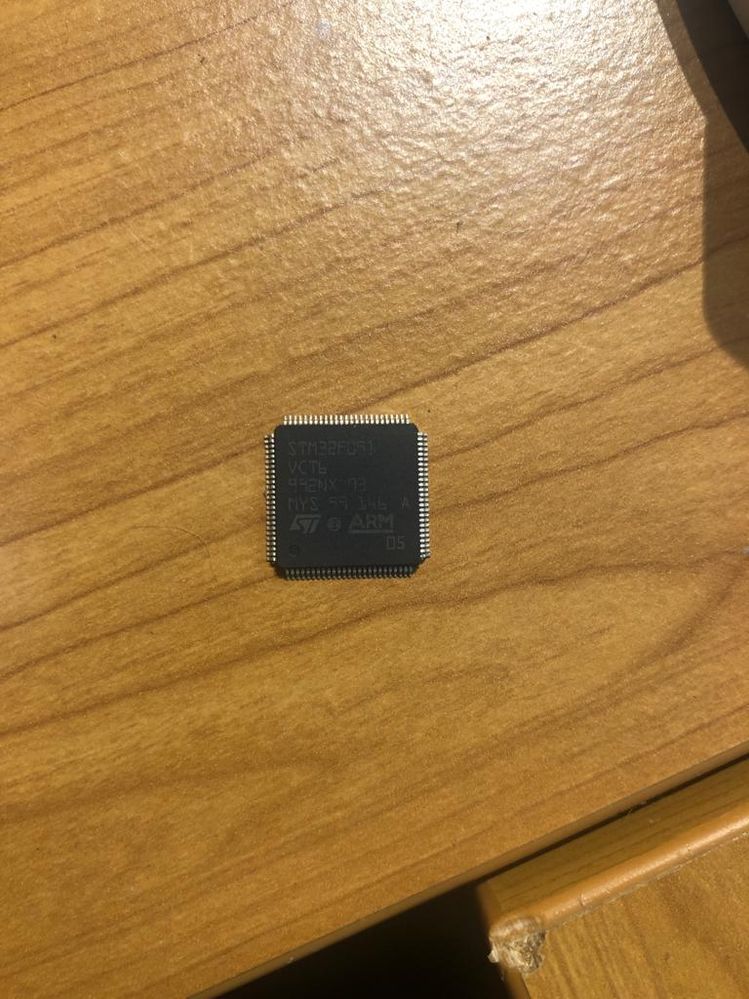

2022-09-14 2:49 AM
Can you join a picture of each MCU? And if possible the sales type.
I will indicate the manufacturing location.
Best Regards,
Gwénolé
2022-09-14 3:32 AM
Please find the both pictures, I hope you could read them. I have only my phone for photo today, but tomorrow, it will be possible for me with a microscope.
Correct MCU :
STM32F091VCT6 A
7B754 93
PHL 7B 115
Defect MCU :
STM32F091VCT6
992NX 93
MYS 99 146 A
2022-09-14 5:16 AM
Quality is good :)
I have to check some information internally, I will probably ask to get some data soon.
Normally this kind of drift is scraped in production.
