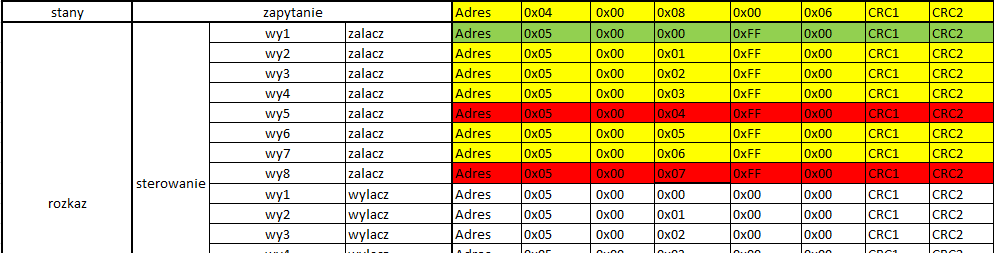

You all focused on race condition and cant understand one thing so ill try to show you something:
Those in color are only possible packages for now
1st yellow one is stany - it goes every 2 seconds and works properly
those from rozkaz part in yellow works properly
red ones when sent work as if i sent green one
green one works properly.
If i had race condition on bufor[3] i would have all orders on yellow switched to green too.
But only those two red dont work. Why would race condition be triggered only on those 2 and not all of them?
